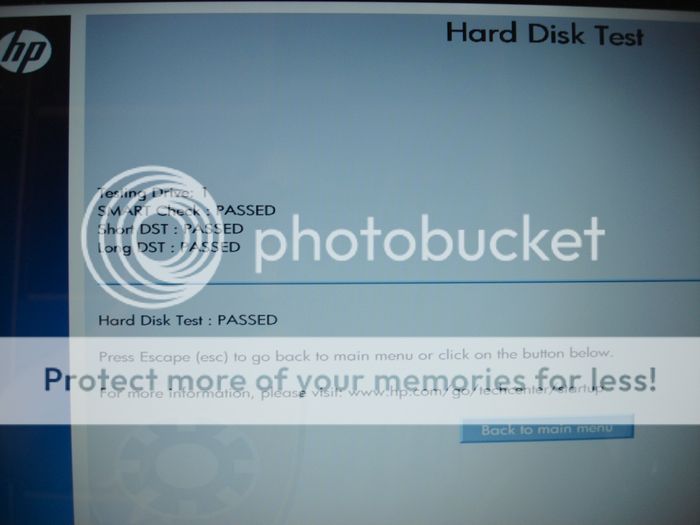

Quasi sicuramente quel disco fisso ha qualche problema di funzionamento .
Per verificare puoi provare a fare un test utilizzando il programma diagnostico che trovi sul sito del produttore del disco fisso .
Magari metti anche una foto completa di tuti i dei dati s.m.a.r.t. del disco fisso cosi vediamo che tipo di problemi puo avere il disco .

Per il momento ho effettuato un test, durato circa 2 ore, con il tool di HP presente (credo) nel bios, e il risultato è questo:

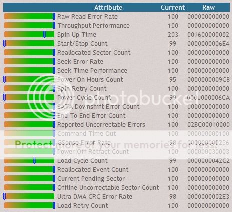

Poi ho anche fatto una analisi veloce con SpeedFan, che nella sezione S.M.A.R.T. mi dà questo:
"Your hard disk is a Hitachi HTS727550A9E364 with firmware JF3OA0E0.
The average temperature for this hard disk model is 37°C (min=25°C max=51°C) and yours is 37°C.
All the attributes of your hard disk are above the S.M.A.R.T. thresholds set by the manufacturer. This is good.
NOTE : your hard disk Power On Hours Count attribute current value (95) is below the normal range (98 - 100) reported for your specific hard disk model. Basically your hard disk was powered on for more than the maximum time the average user did. This means that either all of the reports collected are from hard disks that were not powered on for too long (this is realistic for recent models) or that your hard disk is becoming old. Usually this is not considered as a pre-failure advisory, but you should check whether you want to replace the hardware or keep an eye on its performances over time.
WARNING : your hard disk Ultra DMA CRC Error Rate attribute current value (98) is below the normal range (98 - $issue.params[2]) reported for your specific hard disk model. This usually means that some communication errors occurred between the hard disk and the external controller. Most likely those errors are due to the cable. Double check it, reroute it and, if needed, replace it.
NOTE : your hard disk Power Cycle Count attribute current value (99) is below the normal range (100 - 100) reported for your specific hard disk model. Basically your hard disk was power cycled more times than the maximum number the average hard disk was. Power cycles put some stress on the hard disk mechanic. Sometimes power cycles can be caused by a loose hard disk power connector. Make sure it is properly fastened.
The overall fitness for this drive is 98%.
The overall performance for this drive is 88%."

I dati s.m.a.r.t. sembrano a posto , l' errore Ultra DMA CRC Error Count puo essere dovuto sia o al cavo sata , ma nel tuo caso hai un portatile , quindi non c' e il cavo sata , o alla scheda elettronica del disco fisso che si sta guastando .
Anche la temperatura elevata raggiunta dal disco fisso puo creare degli errori , se utilizza il programma hdtune puoi controllare che la temperatura del disco non superi i 50 °C massimi , altrimenti potrebbero crearsi degli errori nei dati del disco .
Scusa l'ignoranza, in che senso il cavo sata non c'è?! Perché, scusa se dico una banalità, ma un cavo che collega l'hard disk alla scheda madre c'è, tant'è che in questi giorni ho provato più volte a collegarlo/scollegarlo nella speranza cambiasse qualcosa...
Per la temperatura non mi pare abbia mai superato i valori limite (ad esempio dopo il test HP durato due ore era salita a 43 °C, quindi comunque un valore non altissimo), ma in questi giorni, sperando che il pc continui ad avviarsi, continuerò a controllare...
Ah, ho scaricato il tool di Hitachi e domani vedrò di fare un test anche con quello (ora sto scrivendo da un altro pc), anche se devo prima capire quali impostazioni scegliere all'inizio (si può scegliere il tipo di controller, e al momento non so qual è quello giusto per il mio hard disk)...

Cambia il cavo sata.
Dai dati SMART il disco sembra buono .

Intanto, con HD Tune, il valore Data dell'errore DMA CRC è salito a 764, e nel frattempo, a forza di staccare e riattaccare l'hard disk, ho pure dovuto fare un ripristino del sistema operativo...
Sto vedendo un po' per il cavo, pensavo fosse una cosa molto più semplice da trovare, e invece non ci sto capendo niente...

Continuando a cercare in giro, ho letto che, pure se cambiassi il cavo, il valore Ultra DMA CRC Error Count non cambierebbe..confermate?!
In pratica, anche se trovassi qualche anima pia con il mio stesso notebook e che mi prestasse il suo cavo (già provato con un conoscente, purtroppo non mi ha voluto fare questo favore), non potrei capire immediatamente se il problema è del cavo o meno, giusto?!
Nel frattempo il numero di errori è rimasto stabile e il pc sta funzionando..non so davvero come agire, anche perché ho cercato il cavetto ovunque e ho trovato solo qualcosa su ebay, che però son comunque copie cinesi che costano abbastanza e delle quali non saprei se fidarmi....

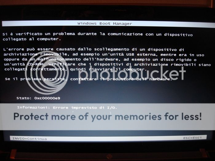

Dopo oltre un mese in cui era filato tutto liscio, ieri si è ripresentato un problema col mio pc, questa volta leggermente diverso..vi posto direttamente la schermata di errore:
Riavviando semplicemente continuava a ripresentarsi questa schermata, allora ho tolto l'hard disk dal suo alloggiamento, staccato e ricollegato il cavo, e riavviato il pc, che dopo circa un'ora di ripristino Windows, è ripartito...
Intanto l'errore Interface CRC Error Count, rimasto costante fino a quel momento, è salito da 764 a 782 (e pochi minuti fa a 784), con i valori Current e Worst scesi da 98 a 97...
Il principale indiziato resta sempre il cavo, giusto?!
Maiden26 è offline   Rispondi citando il messaggio o parte di esso

Penso di si. Gli errori Interface CRC sono tipici dei cavi e, finché non provi a sostituirli, è difficile ipotizzare qualcos'altro. Andrebbe prima esclusa la causa più probabile, ovvero il cavo difettoso.
Sono errori di comunicazione che possono produrre problemi, rallentamenti e malfunzionamenti di entità variabile in funzione di ciò che il PC sta facendo nel momento preciso in cui il fatto si verifica.
