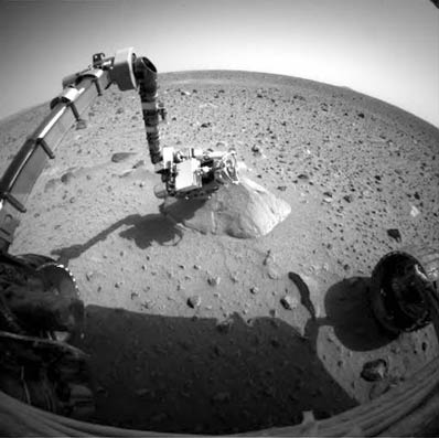

Messaggi: 1638
Photo received from recovering Spirit rover
BY JUSTIN RAY
SPACEFLIGHT NOW
Posted: January 28, 2004
Working as space-age surgeons 100 million miles away, ground controllers are trying to precisely pinpoint the software glitch that halted the Mars rover Spirit's mission to explore Gusev Crater last Wednesday. If successful, officials say the robot geologist could be out of recovery and back at work early next week.
In a promising development late today, Mission Control released the first photograph taken by Spirit since the rover's computer problems began. It shows the rover's science arm reaching out to examine a pyramid-shaped rock nicknamed Adirondack.
Spirit took this image on January 28 and relayed it to Earth, the first picture from the rover since problems began a week earlier. Credit: NASA/JPL
As seen by the rover's front-facing hazard-avoidance camera, the arm remains where it was on the morning of Sol 18 when things began to go awry. The German Mossbauer Spectrometer instrument is seated over the rock in a search for iron-bearing minerals.
After finishing the Mossbauer investigations, the arm was supposed to use the Rock Abrasion Tool to scratch away part of Adirondack's exterior to create a window inside. But that never occurred.
Spirit's computer system, its flash memory bogged down by too many data files, began a continuous series of resets. Contact with Earth was lost for a time.
Now, controllers have managed to get a better handle on their $400 million spacecraft to find the exact source of the problem and delete old files that aren't needed.
"We are attempting to get a trace from the flight software of the problem and compare that to what we believe it to be, what we have seen in the testbed, make sure we are correct and then move forward in deleting some of the files from our flash file system as a result of understanding the problem," mission manager Jennifer Trosper said Wednesday.
"We are extremely careful because we want to make sure that we don't make an error in deleting files. The we have done file deletes on the spacecraft before, so we've shown that does work. The file directories have all different names and you can convince yourself that you are actually deleting the right thing."
Controllers are trying to run a computer script in the rover to track down the bug. But as of mid-day Wednesday, Trosper said things had not gone according to plan.
"Over the past two days we have had some difficulty getting the script to run on the vehicle. So we are continuing to work that problem.
"The method we are using right now in running this script -- it's kind of a back door into the flight software -- is a fairly surgical technique to identify the exact problem and deal with that little problem.
"If we are not able to successfully complete our surgical technique, we have larger hammers, we like to say, that we can use in order to solve this problem."
By strategically going after the bug, officials hope to preserve useful data still stored in the flash memory for later playback to Earth.
"The intent of the last few days has been to maintain the state of the flash memory. We actually think that the flash is not corrupt. We would like keep the data that's in the flash memory. If we can't do that based on the technique we're trying to use then the next step we have is to actually delete the data that is in the flash memory. We've talked to the science team. Almost all of the data is replaceable."
Science information waiting in the flash memory includes the Alpha Particle X-Ray Spectrometer and Mossbauer Spectrometer data collected during studies of the Adirondack and earlier collaborative observations between Spirit and the European Mars Express orbiter.
The preview-like thumbnail images of the joint rover/orbiter research have already been received from Spirit, giving scientists some data to use if the rest can't be recovered.
"Most of the science that was desired to be done can be done from the thumbnail images. The science team has agreed that is adequate for the focus of the experiment we had with Mars Express. Clearly, they would like to get the rest of it down. But in order to get all the data down it would take many sols and we have make a risk trade here and a time trade," Trospher said.
"We will attempt the surgical technique about one more day. If that doesn't work, we will move forward to the less-surgical techniques. And hopefully if we are on the right track we would hope at the earliest be back doing science early next week. If we're not on the right track, it could take longer than that."
A specialized group of engineers were brought together to revive Spirit last week and coax the rover back into action. The control team will be returning to its full size in the coming days, if all goes well.
"The anomaly team right now is probably 15 to 20 people because it is a focused effort on solving this flight software problem. Last night, we went to adding probably another 10 people to move towards doing our nominal timeline. And in a few nights, we will go to the full overnight timeline of staffing with the science and engineering teams in preparation for getting Spirit back on its feet for the science mission."

In the upcoming days, Spirit will finish the study of its first rock, nicknamed Adirondack. The Rock Abrasion Tool will be used to scrub off the rock's surface to give the science instruments a window into Adirondack's interior.
This close-up look at Adirondack was captured by Spirit's microscopic imager. This is the first-ever microscopic image of a rock on another planet. Credit: NASA/JPL/US Geological Survey
Spirit's Mossbauer Spectrometer made readings of the pyramid-shaped, football-sized rock's composition and the microscopic imager snapped extremely close-up views prior to the computer problems. That data was finally transmitted to Earth late last week.
"If you had a hammer and whacked that rock, it would ring," said Ray Arvidson, rover deputy principal investigator.
Adirondack is a hard, crystalline rock that contains olivine, pyroxene and magnetite minerals. Researchers say that composition is common in Earth's volcanic basalt rocks. It isn't the proof of past water on Mars that the rovers were sent to find.
"Adirondack seems to be a good, hard volcanic rock," Arvidson said. "That suggests to us that we may be looking at material either excavated from below by craters, or broken out lava flows or transported in. It's not the kind of smoking gun evidence that we are looking for in terms of climatic history."
Two of Spirit's potential target rocks, which are near the rock called Adirondack, are seen here. The rock on the left has been named "Cake," and the white rock on the right has been named "Blanco." Image Credit: NASA/JPL/Cornell
Next, Spirit will drive to a nearby light-colored rock for study. Future plans call for the rover to head toward a crater, nicknamed Bonneville, about 820 feet away to study rocks thrown outward by the crater-forming impact.
"I suspect what we will do is take a look at some of these so-called white rocks that might be dusted basaltic rocks. If they don't look interesting, as quickly as possible do a traverse up to Bonneville Crater," Arvidson said.
