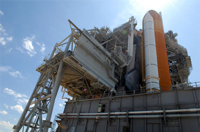

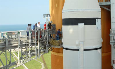

Preparing Endeavour
In this image, taken June 14, workers on Kennedy Space Center's Launch Pad 39A prepare to remove the 7-inch quick disconnect and flight seal from the Ground Umbilical Carrier Plate, or GUCP, on space shuttle Endeavour's external fuel tank. Teams are removing the hardware to change out seals in the internal connection points. The GUCP is the overboard vent to the pad and the flare stack where the vented hydrogen is burned off.
On June 12, a hydrogen leak caused the STS-127 mission to be scrubbed. Endeavour is scheduled to launch on its STS-127 mission on June 17, 2009, at 5:40 a.m. EDT.

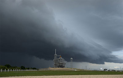

Infatti...
SNF:
Hydrogen leak scrubs shuttle Endeavour launch again
BY WILLIAM HARWOOD
STORY WRITTEN FOR CBS NEWS "SPACE PLACE" & USED WITH PERMISSION
Posted: June 17, 2009
After a lengthy fueling delay because of stormy weather, launch of the shuttle Endeavour on a space station assembly mission was scrubbed early Wednesday when a presumably repaired hydrogen vent line umbilical began leaking potentially dangerous vapor for the second launch try in a row.
