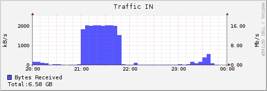

(scusare il doppio post di fila)
Piccole soddisfazioni: anche la mia linea disastrata riesce ad usare tutta la banda disponibile quando scarica da steam
Codice:
    VDSL Training Status:   Showtime
                    Mode:   VDSL2 Annex B
            VDSL Profile:   Profile 17a
            Traffic Type:   PTM Mode
             Link Uptime:   12 days: 7 hours: 56 minutes
       VDSL Port Details       Upstream         Downstream
               Line Rate:      1.042 Mbps       16.800 Mbps
    Actual Net Data Rate:      1.043 Mbps       16.801 Mbps
          Trellis Coding:         ON                ON
              SNR Margin:        6.3 dB            6.5 dB
            Actual Delay:          0 ms              0 ms
          Transmit Power:       10.4 dBm          10.5 dBm
           Receive Power:       -1.5 dBm         -32.5 dBm
              Actual INP:       55.0 symbols      55.0 symbols
       Total Attenuation:       11.8 dB           43.0 dB
Attainable Net Data Rate:      0.986 Mbps       17.396 Mbps
      VDSL Band Status    U0      U1      U2      U3      D1      D2      D3
  Line Attenuation(dB): 11.9     N/A     N/A     N/A    28.6    102.3    102.3
Signal Attenuation(dB): 11.9     N/A     N/A     N/A    43.1     N/A     N/A
        SNR Margin(dB):  6.3     N/A     N/A     N/A     6.5     N/A     N/A
   Transmit Power(dBm): 10.4     N/A     N/A     N/A    10.6     N/A     N/A
