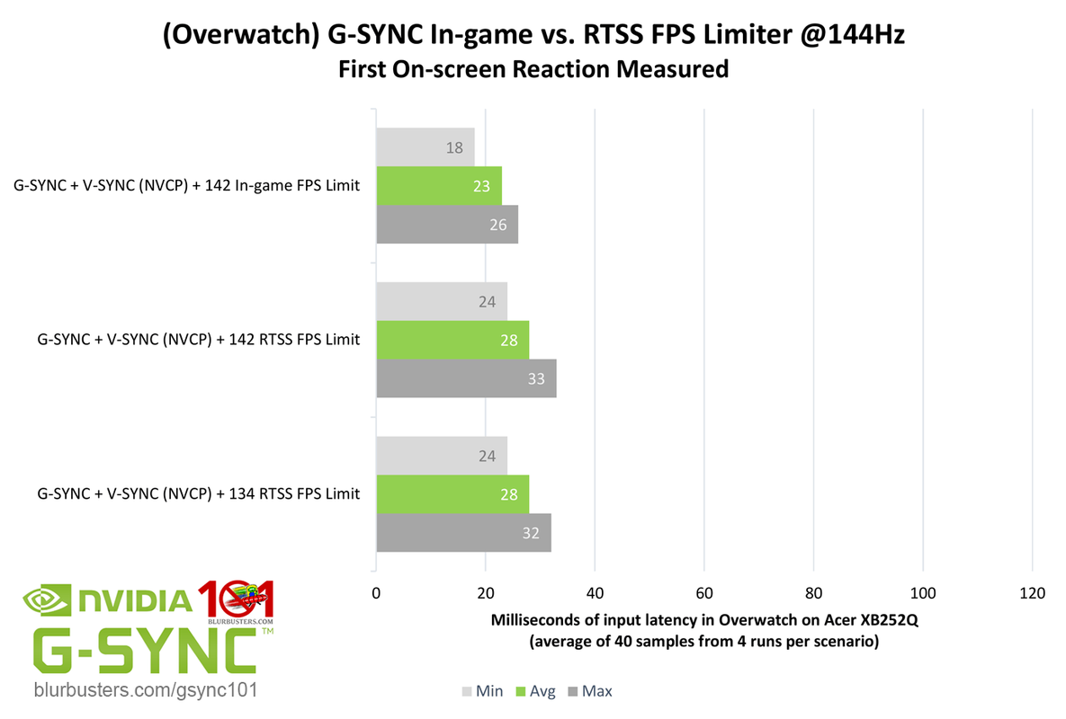

Non è preferibile:
Say the system can maintain an average framerate just above the maximum refresh rate, and instead of an FPS limit being applied to avoid V-SYNC-level input lag, Fast Sync is enabled on top of G-SYNC. In this scenario, G-SYNC is disabled 99% of the time, and Fast Sync, with very few excess frames to work with, not only has more input lag than G-SYNC would at a lower framerate, but it can also introduce uneven frame pacing (due to dropped frames), causing recurring microstutter
https://blurbusters.com/gsync/gsync1...nd-settings/8/
Più inputlag e microstutter.
Effettivamente è cosi, fatto delle prove e sinceramente con il fastsync non si può giocare, Microstutter frequenti.
Il miglior setting rimane il classico:
GSYNC+VSYNC (NVCP) + FPS CAP DAL GIOCO STESSO.
RTSS come limitatore potrebbe introdurre inputlag, cosi come il vsync del gioco stesso:
Nvidia Control Panel V-SYNC vs. In-game V-SYNC
While NVCP V-SYNC has no input lag reduction over in-game V-SYNC, and when used with G-SYNC + FPS limit, it will never engage, some in-game V-SYNC solutions may introduce their own frame buffer or frame pacing behaviors, enable triple buffer V-SYNC automatically (not optimal for the native double buffer of G-SYNC), or simply not function at all, and, thus, NVCP V-SYNC is the safest bet.
ok ma invece avendo due display collegati alla gpu (uno via hdmi-hdmi e uno via dp-hdmi) cosa conviene mettere come vsync?
