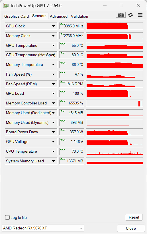

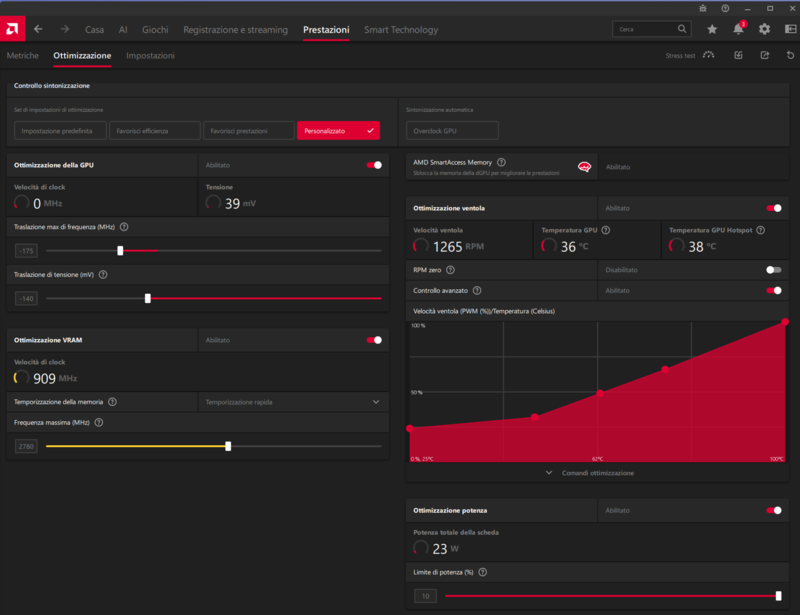

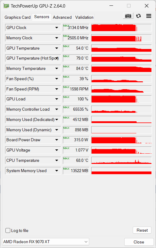

Old 23-03-2025, 19:14   #1253
Blasius
L'Avatar di Blasius
Iscritto dal: Feb 2013
Città: Tra il Futuro e Il Presente
Messaggi: 2096
Un buon Test bello Stressante - https://gravitymark.tellusim.com/ -
14600k standard prima di montare il 13700k --- 9070Xt Pulse
Originals freq
INFO "NB": .... RT OFF == DEFAULT SETTING...
4k Rt on - 12dx
https://gravitymark.tellusim.com/rep...242b0f852bcfcd
Score 28,016
Time 167.0 s
FPS 167.7
Min / Max 93.8 / 244.1
4k Rt off - dx12
https://gravitymark.tellusim.com/rep...0f295048156356
Score 31,034
Time 167.0 s
FPS 185.8
Min / Max 127.0 / 366.3
2k Rt on - 12dx
https://gravitymark.tellusim.com/rep...9ea56c01af2f70
Score 44,827
Time 167.0 s
FPS 268.4
Min / Max 156.9 / 350.1
4k Vulkan Rt on
https://gravitymark.tellusim.com/rep...53323dc060f5d5
Score 29,118
Time 167.0 s
FPS 174.3
Min / Max 93.5 / 259.2
4k vulkan Rt off
https://gravitymark.tellusim.com/rep...3e5966df24dcde
Score 29,529
Time 167.0 s
FPS 176.8
Min / Max 127.2 / 354.3
Oc mode On 9070xt Pulse
-140mv Pl10+ Mem 2750mhz Oc
4k Rt On -dx12
https://gravitymark.tellusim.com/rep...775ab3715bcf57
Score 30,224
Time 167.0 s
FPS 181.0
Min / Max 99.3 / 260.9
4k Rt off -dx12
https://gravitymark.tellusim.com/rep...18e2f6ec769b20
Score 32,987
Time 167.0 s
FPS 197.5
Min / Max 139.4 / 392.9
2k Rt on dx12
https://gravitymark.tellusim.com/rep...0eae5871392a29
Score 47,963
Time 167.0 s
FPS 287.2
Min / Max 163.7 / 372.6
4k vulkan Rt on
https://gravitymark.tellusim.com/rep...5ea31d881eaebe
Score 30,601
Time 167.0 s
FPS 183.2
Min / Max 100.8 / 266.1
4k vulkan Rt off
https://gravitymark.tellusim.com/rep...bd38ac916fc53b
Score 31,287
Time 167.0 s
FPS 187.3
Min / Max 137.5 / 374.6
Freq e temp max rilevate in Original Mode
Freq e temp max rilevate in OC MOD
Vediamo i vostri se volete ^_^
--- Top ---
