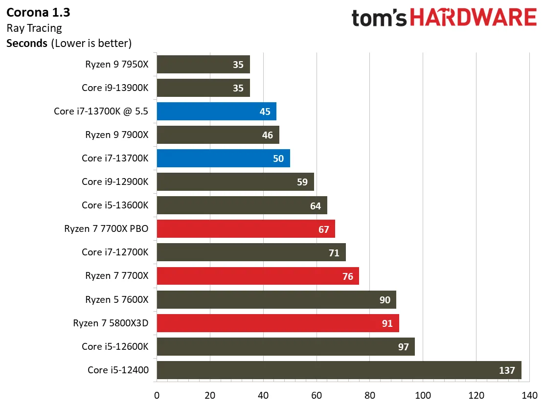

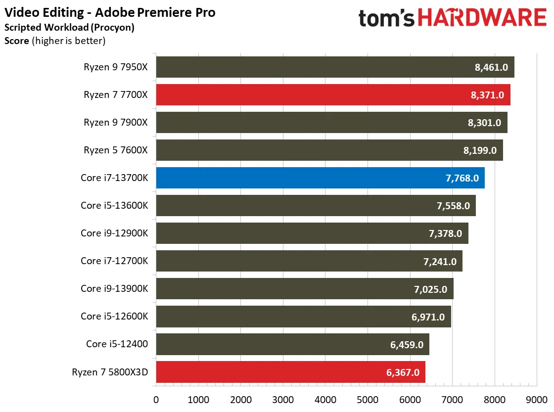

eventualmente un 13600K che stressa meno e nn poi chissa quanto meno potente del 13700K
https://cdn.mos.cms.futurecdn.net/AV...00-80.png.webp
https://cdn.mos.cms.futurecdn.net/mi...00-80.png.webp
