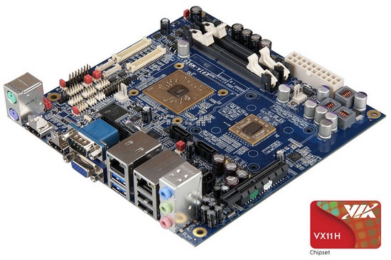

per la cronaca riporto l'annuncio da parte di VIA della nuova scheda madre mini-ITX EPIA- M920:
http://www.viaembedded.com/en/produc...EPIA-M920.html
- Active and passive cooling configurations
- DirectX 11 and 3D stereoscopic display
- Hardware acceleration for MPEG-2, MPEG-4, WMV9, VC-1 and H.264 video
- Support for up to 16GB of DDR3 at speeds up to 1333MHz
- Rich connectivity options with support for 2 HDMI ports, one VGA port and two 18/24-bit LVDS
- Supports dual Gigabit Ethernet, three USB 3.0 and six USB 2.0 ports
- Four COM ports and support for SD (SDXC/SDHC)
- Available with ATX or DC-in power supply support
- Windows 7/WES7/ XP, and Linux OS & driver support
- Designed for advanced Industrial Automation, POS, Kiosk, ATM, Gaming, Digital Signage, Healthcare and Digital Media Applications
