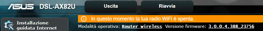

Old 11-09-2023, 15:32   #1375
ness.uno
Messaggi: 2600
Nuovo FW ASUS DSL-AX82U Firmware version 3.0.0.4.388_23756
Nuovo? https://dlcdnets.asus.com/pub/ASUS/w...odel=DSL-AX82U
