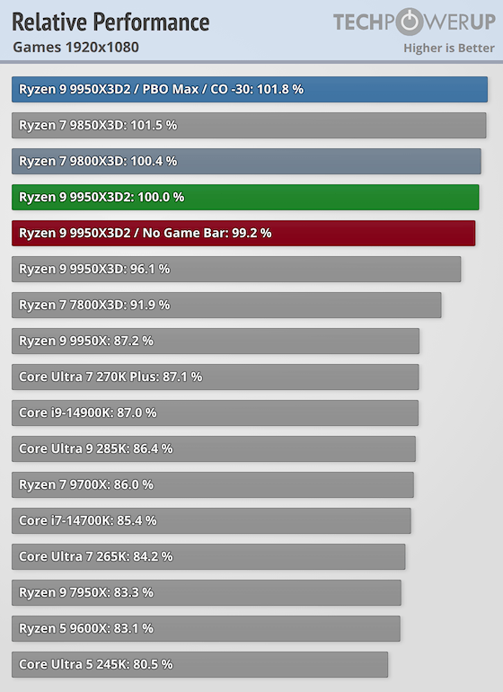

https://www.techpowerup.com/review/a...-dual-edition/
