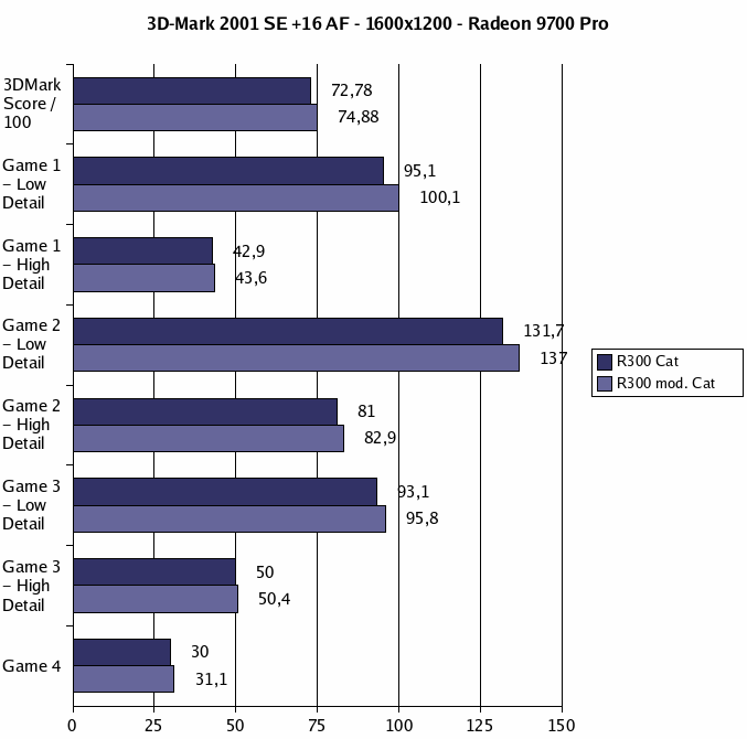

Driver per la 9800 adattati alla 9700: Boost di prestazioni!
Come da topic. I driver "incriminati" sono i nuovissimi 6307 che contengono anche le nuove schede ATi con chip R350
Ecco quanto riporta Warp2Search:
Thomas Bruckschlegel of TommTi-Systems has somehow enabled the R350 driver path, which is naturally present in the latest ATI beta drivers v6307, to work on R300 hardware a.k.a Radeon 9700 Pro / 9700 / 9500 Pro / 9500. Modifications were performed on ati2mtag.sys.
The interesting thing about this modification is that it brings a slight performance increase in various applications. Also the control panel detects the changed driver path correctly.
Read More...
Thomas at first thought these differences were a result of normal performance fluctuations. But since they were reproducable he concluded that the hardware difference between R300 and R350 might not be as large as ATI would like us to believe.
He used the following software. Note that the number in brackets shows the approximate performance difference to standard R300 path.
Test System:
Athlon XP 1800+
Radeon 9700 Pro
Windows XP SP1
Results:
  • Fablemark [4%]
  • 3DMark 03 | 1024x768 Default | [3-5%]
  • 3DMark 03 | 1024x768 16x AF | [up to 20%]
  • 3DMark 03 | 1024x768 2x FSAA | [up to 10%]
  • 3DMark 03 | 1024x768 4x FSAA | [up to 10%]
  • 3DMark 2001 SE | 1600x1200 | [Pixel Shader 1.1 40%; generally faster]
  • 3DMark 2001 SE | 1600x1200 16x AF | [generally faster]
  • ATI Island Demo 1 [partially 19% faster]
  • Shader Mark 1.7 | DX8 | [generally faster]
  • Shader Mark 1.7 | DX9 | [even more faster]
  • Shader Mark 1.7 | DX9 PS2.0 | [up to 23% faster]
  • Z-Reject Overdraw Tester 1.6 | [up to 4% faster]
Il tutto tratto da TommTi-Systems
Vi metto nel dettaglio quanto emerso dal 3D Mark 2K1 a 1600x1200, il resto lo si trova cliccando sul sito tedesco:

Non sono tanto convinto che i benefici derivino dalle funzioni destinate alla 9800.
Se, come anandtech e toms dicono, r350 ha delle piccole varianti nell' HDL, allora pur avendo lo stesso numero di transistor i chip sono fisicamente diversi.
L'Hardware Description Language durante la sintetizzazzione (la trosformazione del diagramma e dello schema logico del progetto, alias gpu, in un circuito) produce circuiti diversi, ovvero gpu fisicamente diverse, di pochissimo visto il tempo record in cui è uscito r350 (per programmare e sintetizzare tramite i linguaggi DHL una gpu ci vogliono mesi), ma comunque diversi.
Se si hanno tali incrementi probabilmente è perchè la programmabilità del chip è sufficiente a delegare ai driver la definizione di fattori di compressione che determinano l'applicazione di alcuni filtri, mi riferisco allo smoothvision 2.1, cioè i parametri che determinano AA e AF, che passano da un fattore di compressione di 6:1 della 9700 a 8:1 della 9800, sempre secondo quanto dichiarato dai sopracitati siti, e sempre che tali aumenti di prestazioni maneggiando i prossimi driver siano reali.
Per quanto riguarda lo smartshader 2.1 credo che le differenze siano proprio a partire dal DHL, quindi non colmabili da modifiche software.

ti spiego perchè non ne sono convinto. L'F-Buffer non è altro che un buffer in cui vengono immagazzinati i PS che richiedono istruzioni troppo "lunghe" per essere trattati alla stregua degli altri e necessitano, perciò di una particolare elaborazione. L'R300 fa già largo uso di buffer interni e alcuni di questi, guarda caso, hanno a che fare con i PS: quelli in cui vengono immagazzinate le textures che permettono l'applicazione di fino a 16 textures per single pass su ogni pixel elaborato dalle pipelines. Attualmente questi buffer sono notevolmente sottoimpiegati (nessun gioco arriva a richiedere l'applicazione di 16 textures p.s.p. e, oltretutto, le stesse specifiche DX9 non prevedono la necessaria applicazione di 16 textures, ma l'applicazione di "fino a 16 textures" p.s.p. Riscrivendo solo la parte di programma relativa al funzionamento dei buffer dei PS, si può ottenere che gli stessi svolgano anche il compito relativo all'F-Buffer.
D'altra parte qualcosa del genere l'abbiamo già visto con la modifica 9700->Fire X1 (due chip con comportamento molto diverso con applicazioni OpenGL pro che sono in realtà lo stesso chip con abilitate o disabilitate alcune funzioni, semplicemente via software). Se, come sembra, il numero dei transistor non è cambiato tra R300 e R350, ritengo improbabile che si sia agito a livello di riorganizzazione interna della struttura del chip. E' più semplice ottimizzare l'uso di strutture già presenti all'interno del chip stesso, che adesso sono notevolmente sottoimpiegate, migliorandone l'efficienza semplicemente facendole "lavorare di più" di quello che le attuali applicazioni le obbligano a fare.
