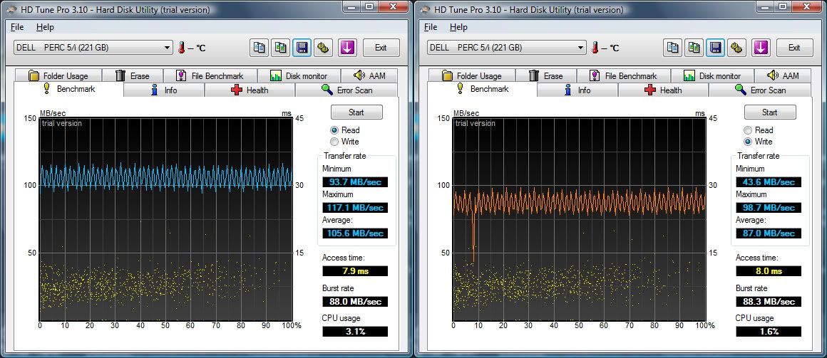

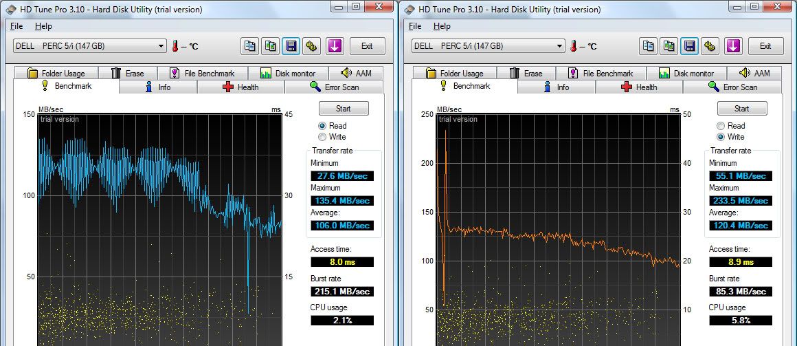

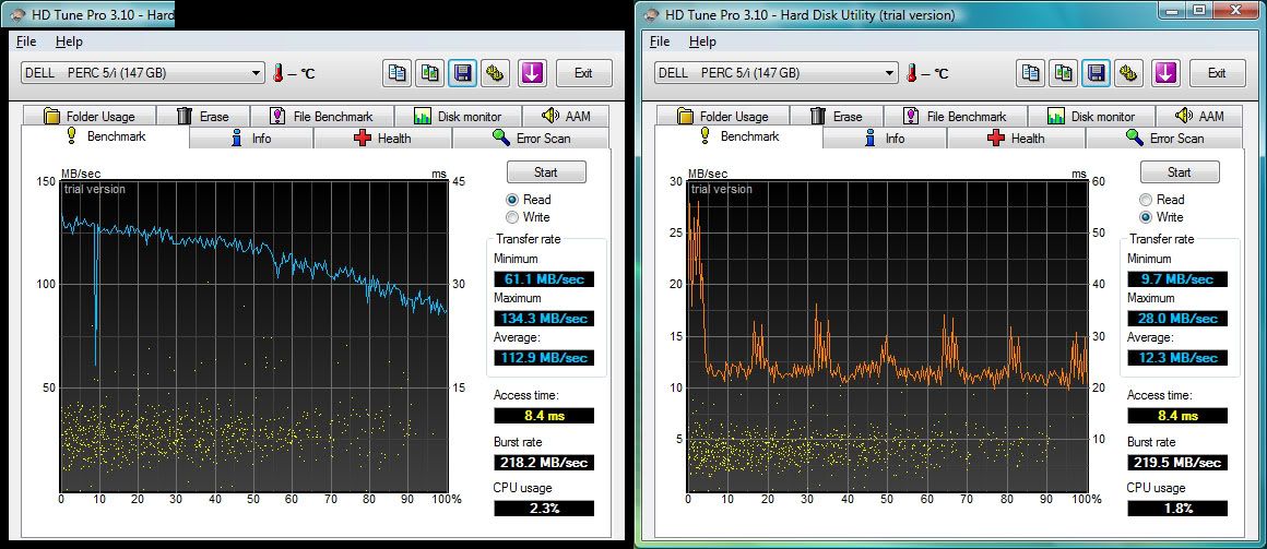

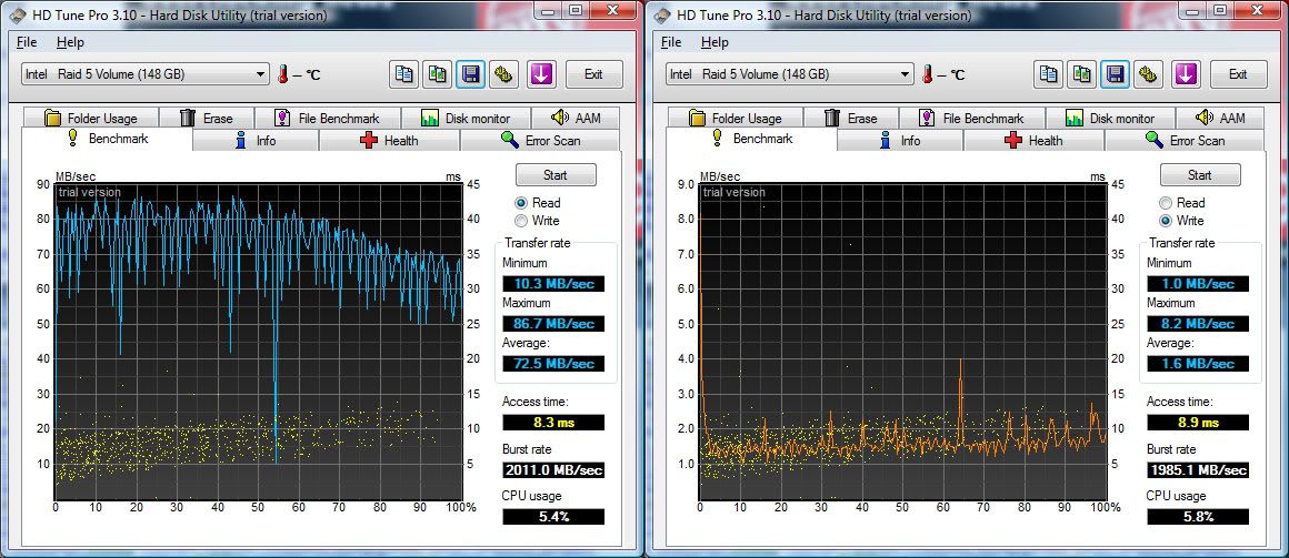

Benchmarks of PERC 5/i vs ICH9R
Test System
[email protected]
4GB DDR2-1095
Vista 64 (Defrag and SuperFetch Disabled)
OS HDD: Seagate 7200.10
Test HDD: 3x WD Raptor 8MB WD740GD-00FLC0
HDTune using 64KB Sectors.
Terminology
Read Ahead: system tries to predict what part of files will be needed and preloads them into memory. This boost sequential performance but hurts random performance.
Adaptive Read Ahead: Read Ahead when memory and I/O avaliable with prioritization. Balances sequential and random read performance but takes processing power.
Write Through: Writes from memory to HDs are performed only when the data is complete. Data is not accessible until written to HD.
Write Back: Writes are stored in memory and can be accessed from faster RAM. Data is written to HD when optimal. Performance increases but data is at risk in volitle memory. If power is lost, the stored data in the RAM is lost and never written to disk.
Degraded: RAID5 can operate with one HD missing. Performance is heavily impacted due to parity calculations.
Generalized Results

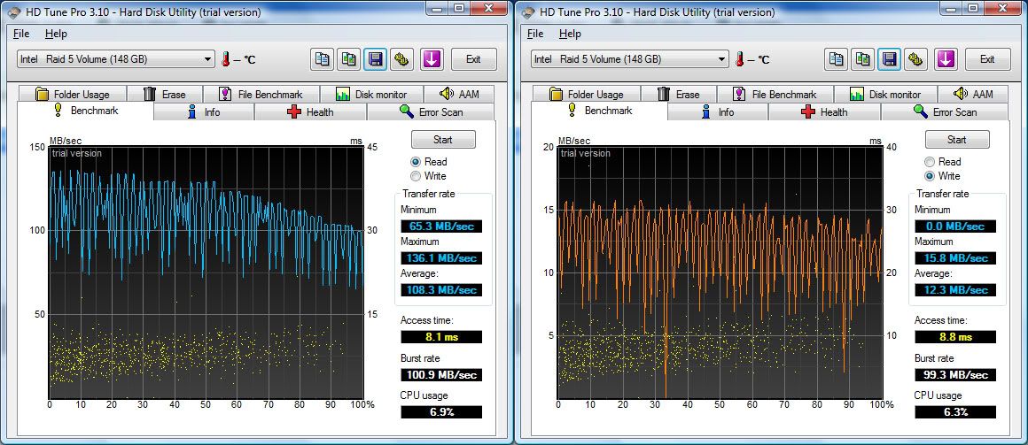

RAID5 write speeds went from 55MB/s to 121MB/s.
RAID5 read speeds remain about the same but much more consistent.

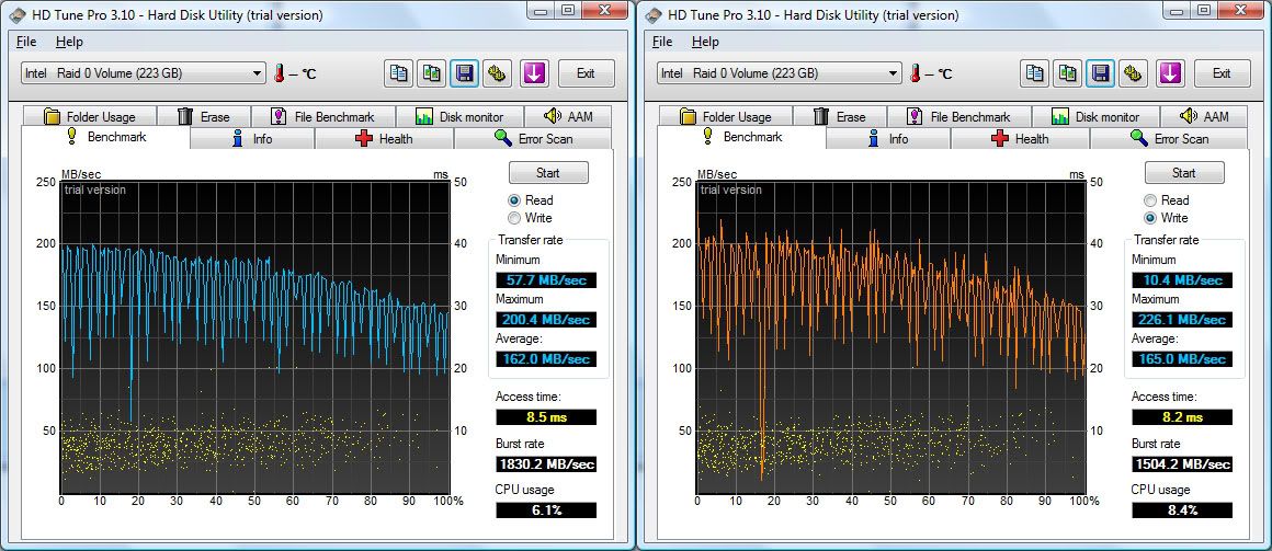

RAID0 write speeds went from 165MB/s to 180MB/s but less consistent.
RAID 0 read speed went from 162MB/s to 182MB/s and MUCH more consistent.
CPU usage was greatly reduced and access time generally only slightly improved.
Please remember this are artificial tests that focus more on sequential performance.
Single Raptor
RAID 5
ICH9R RAID5 w/ Caching [64KB]
ICH9R RAID5 w/o Caching [64KB]
ICH9R RAID5 Degraded w/ Caching [64KB] *Occasional BSoD*

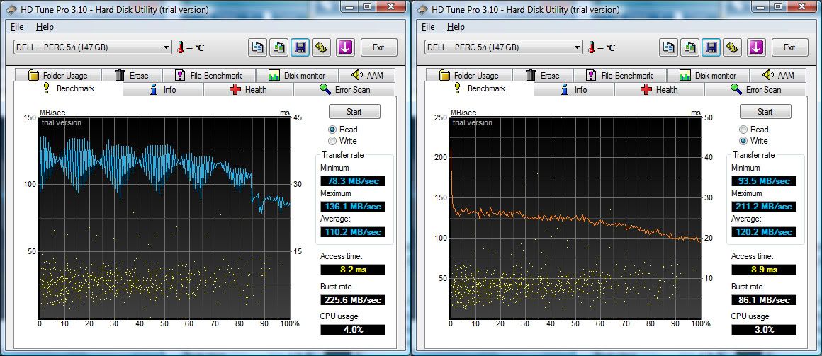

PERC RAID5 (Write-Back, Adaptive-Read-Ahead) [64KB]
PERC RAID5 (Write-Back, Read-Ahead) [64KB]
PERC RAID5 (Adaptive-Read-Ahead) [64KB]
PERC RAID5 (Write-Back) [64KB]
PERC RAID5 Degraded (Write-Back, Adaptive-Read-Ahead) [64KB]

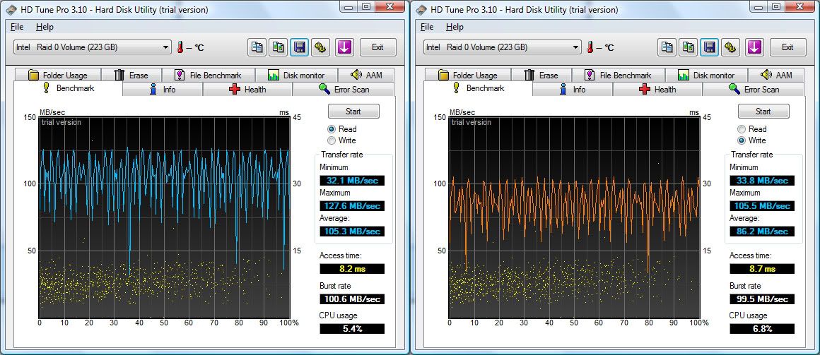

RAID 0
ICH9R RAID0 w/ Caching [128KB]
ICH9R RAID0 w/o Caching [128KB]

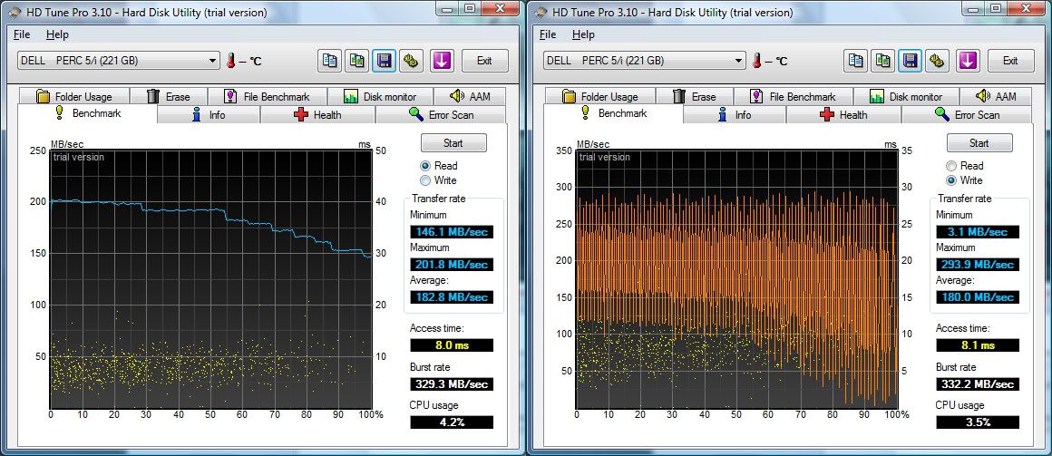

PERC RAID0 (Write-Back, Adaptive-Read-Ahead) [128KB]
PERC RAID0 (Write-Back, Adaptive-Read-Ahead) [1MB]
PERC RAID0 [128KB]

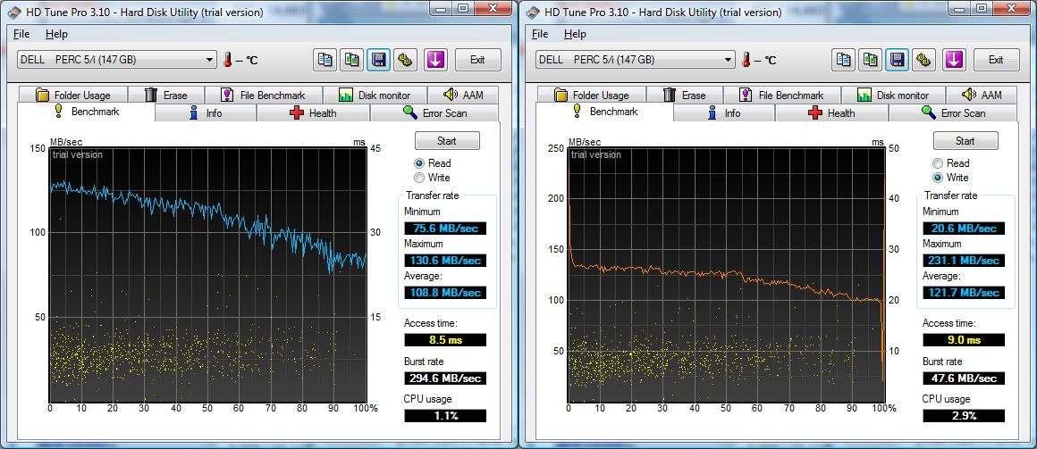

PERC 5/i con 2 ibm sas 15k raid 0 (giusto x dare uno sguardo a cosa puo fare un sas al posto di un raptor )
[/IMG]http://i110.photobucket.com/albums/n111/sumilux/HDTune_Benchmark_DELL____PERC_5_ira.png[/IMG]
[/IMG]http://i110.photobucket.com/albums/n111/sumilux/dellraid0writebenchmark.png[/IMG]

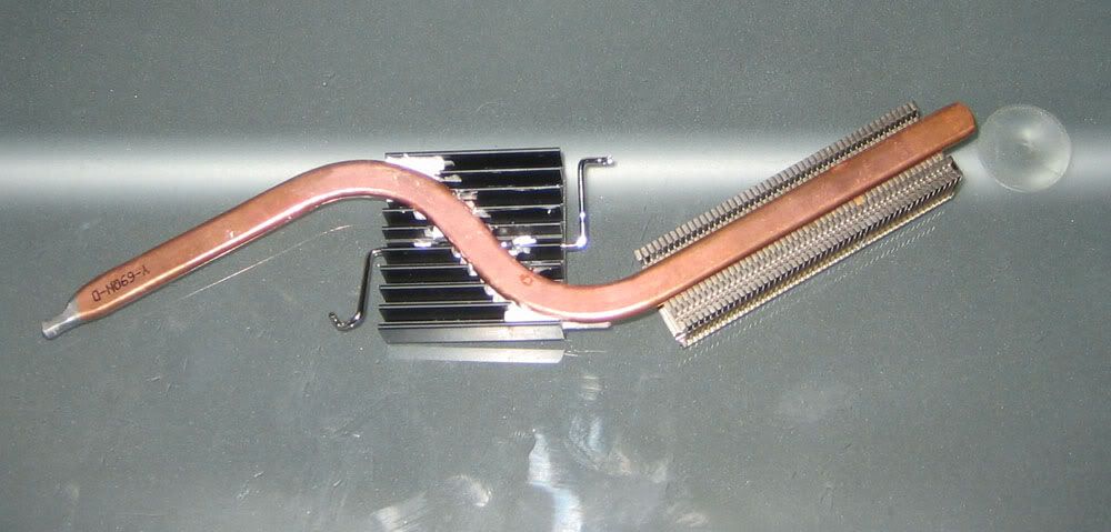

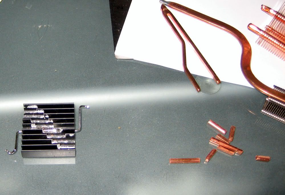

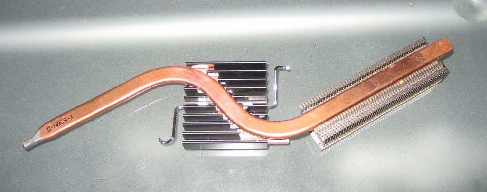

Extra cooling
Come gia scritto la scheda necessita di dissipazione poiche' tende a scaldare moltissimo, questa e' una possibile soluzione, non alla portata di tutti, ma molto efficace
Rimosso il dissi:
Dissi per ram RAMsink sul processore RAID e Thermaltake Spirit HS per la EC-RAM
Dissi stock modificato:
Dissi tolto da un notebook : (notare che sotto e' stato riempito il gap tra residui delle alette e pipe)
Artic silver adesiva usata come collante:
Risultato:
