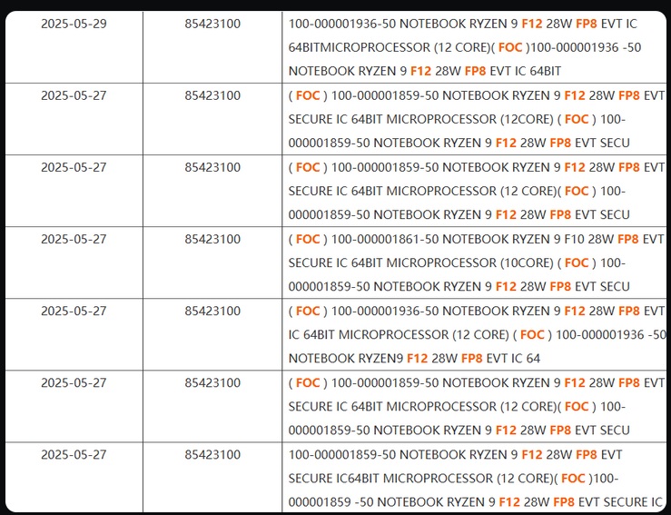

AMD Gorgon Point APUs Spotted In NBD Shipping Manifest: AMD Prepares “Refreshed” Zen 5-Based 10-Core And 12-Core SKUs
https://wccftech.com/amd-gorgon-poin...ping-manifest/
